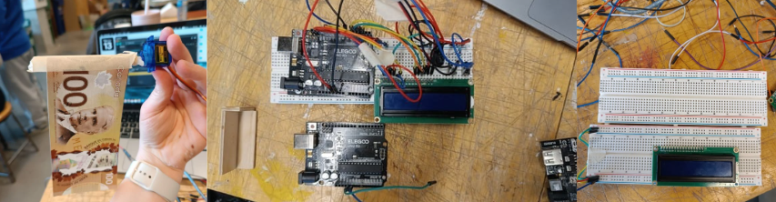

  1. 1x Arduino Uno
  2. 1x LCD screen
  3. 1x Ultrasonic sensor (to detect presence)
  4. 2x LED lights (Red & Green)
  5. 2x Push buttons (Yes/No)
  6. 1x Servo motor (for rolling the money in or out)
  7. 1x Potentiometer (to control the contrast of the LCD)
  8. Wires & Breadboard

Step 1: Coding the Machine
  1. The machine starts in an idle stage, displaying a message like "Waiting for you..." on the LCD.
  2. When the ultrasonic sensor detects a person, the machine activates and begins the process.
  3. The machine teases the player by making the cash roll out slightly from the dispenser.
  4. The LCD screen displays a Yes/No question, prompting the player to respond.
  5. The player presses a Yes/No button, but regardless of the answer, the machine determines whether it is right or wrong based on randomness.
  6. If the machine deems the answer correct: the green LED lights up and the money rolls out slightly further. The machine displays a short phrase such as “Hmm, thought so.”
  7. If the machine deems the answer incorrect: the red LED lights up and the money slides back in. The machine displays a short phrase such as “Hmm, thought so.”
  8. The process repeats for 10 questions.
  9. After the final question, all money retracts completely, and the machine resets to idle mode.

Step 3: Testing & Adjustments
  1. Adjusting servo speed to create a dramatic "almost but not quite" money dispensing effect.
  2. Ensuring the sensor correctly detects a person before displaying a question.
  3. Tweaking LED response time for clear feedback.
  4. Calibrating the potentiometer to ensure the LCD text is readable in different lighting conditions.

Step 7: What Did Not Work Well
  1. Servo Speed Calibration: Initially, the servo motor was too fast, either throwing the money out abruptly or retracting it so quickly that users didn’t even register the movement. Finding the right balance between suspense and speed required multiple iterations.
  2. LED Timing & Visibility Issues: The LED indicators sometimes turned on/off too quickly, making it hard for users to notice whether their answer was considered correct or incorrect. A small delay had to be added to ensure the red or green LED remained on long enough for users to register the feedback.
  3. LCD Contrast Issues: At first, the LCD contrast was inconsistent in different lighting conditions, making the text hard to read. Adding a potentiometer to adjust the contrast fixed this, but it was an unexpected troubleshooting challenge.
