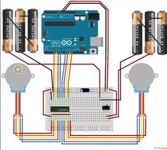

Step 7: Wiring
Install the wiring for the bot.
Quote from original post:
The microcontroller provides 5 volt signals to the darlington array which in turn, provides VCC to the stepper coils:
  1. Start with pin next to the ground pin on the darlington driver, and install orange, yellow, green, and blue wires in that order (Image 1).
  2. Attach the jumpers to the following arduino pins (Image 2):
  3. orange - Digital pin 4
  4. yellow - Digital pin 5
  5. green - Digital pin 6
  6. blue - Digital pin 7
  7. Back at the darlington, continue jumper for the other stepper in the reverse of the others:
  8. blue, green, yellow, and orange (Image 3).
  9. Attach the jumpers to the following arduino pins (Image 4):
  10. blue - Digital pin 9 (pin 8 used latter for the servo).
  11. green - Digital pin 10
  12. yellow - Digital pin 11
  13. orange - Digital pin 12
