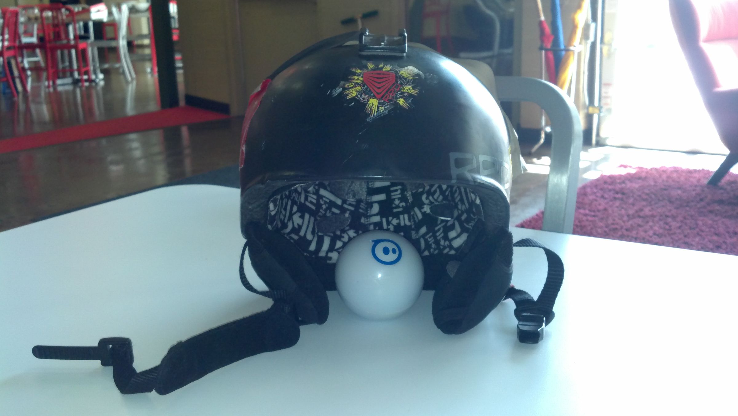

For children with physical disabilities, using a smartphone is almost impossible. However, they can really gain access to the amazing capabilities of a smartphone with a simple button. For example, see my adaptation for controlling Sphero with a tilt of your head.
