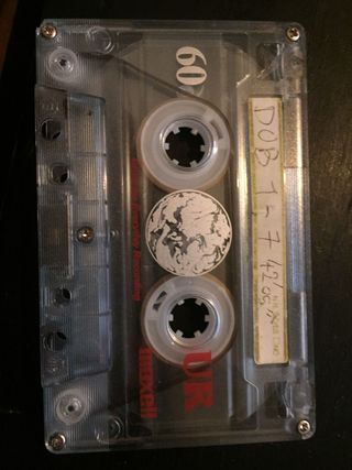

Theoretically it sounds really easy; you can make a tape loop by taping the ends of a short piece of magnetic ribbon together and sticking it back inside the cassette tape. However, if you ever actually tried to do this, you will soon realize that it is a tad bit trickier than one would think. I spent an afternoon working out and refining this science. After many tries and many, throw-my-hands-in-the-air-and-promise-to-give-up sorts of moments, I think I have it down reasonably enough to write instructions for someone else to do it. Now you too can tape the ends of magnetic ribbon together, ?, and profit!

Step 5: Cut Some Magnetic Tape
Cut a section of magnetic tape roughly a foot long.
Step 6: Thread
Position your wheels back inside the tape and thread the magnetic ribbon around the rubber wheel, under the unmodified wheel, around the pulley opposite the rubber wheel, through the channel at the bottom of the tape, around the other pulley and also to the right of the plastic peg (next to the pulley).
In other words, just look at the pictures.
Step 7: Tape
Apply a small piece of double-sided tape on the inside of the magnetic ribbon, pull the loop tight and tape it evenly together.
If the magnetic ribbon is attached at an angle or any tape is sticking off the sides, your tape loop almost assuredly will not work.
Step 8: Washer
Cut a washer out of mat board and stick it on the inside of the case around the opening that lines up with the wheel with the rubber on it.
This provides more pressure on the sides of the wheel and ensures the wheel will spin. I found this to be necessary.
Step 9: Close the Case
Trim away all excess magnet ribbon and close the cassette back up. When reinserting the screws, only tighten them about 80% on the side with the rubber wheel. Readjust tightness as necessary until it plays correctly in your cassette deck.

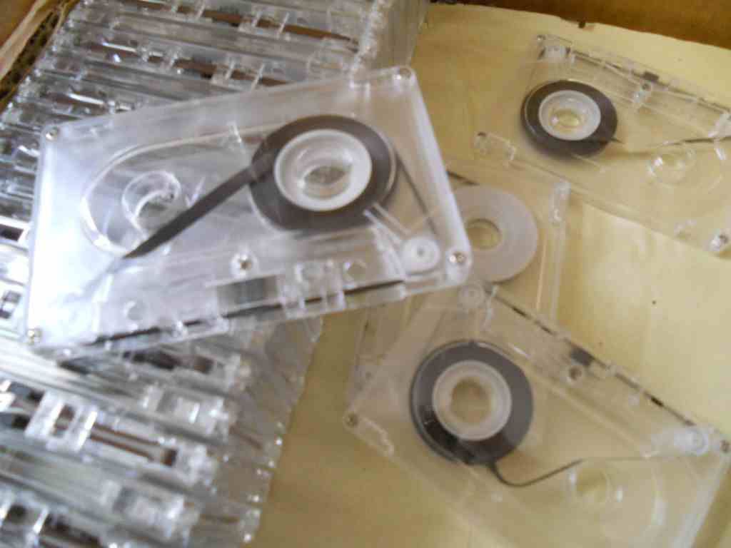

Excellent Instructable! Here is a suggestion for modification to get longer recording time. With a 1" more or less tail extending out of the center of the take-up hub, loosely wind the length of tape you require i.e. 1 second = 1.875 inches of tape. (Thus, if you want a 1 minute continuous loop 60 sec here is the math. 60 x 1.875 = 112.5 inches or 9.375 feet of tape.) Then thread the tape from the inside of the spool as shown in the Instructable. Then make your splice to the end piece winding on the outside and VOILA, endless loop tape for your time needs. Here is a link showing a pic of an endless loop cassette with 12 minutes of time on it. Hope this helps, enjoy.

mmillere6 - With a longer time of tape winding on to the outside and feeding out the center a slightly different spindle is required. The take-up spindle must be an inverted cone shape to allow the tape to slide UP out of the center of the take-up as the spindle turns. A vertical sided reel of a standard cassette case will have too much friction and bind as you are experiencing. Here is a current link to Ebay for a single blank if more play time were required cutting, splicing, then adding the required length would do the trick. If you were wanting to make more tapes you could disassemble this one and make a mold casting of the spindle to modify a standard cassette. I hope this helps you, good luck.
