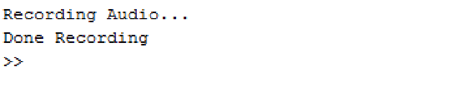

You can now run the program by either pressing F5 or clicking the green Run button.
When the program runs the console window will display "Recording Audio..." followed by "Done Recording" when the audio is no longer being recorded. After this is done, all the audio data will have been stored in a file labeled 'AudioData.dat'.

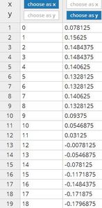

Click IMPORT.
Your data should appear in two columns. The left column represents your X values and the right column represents your Y values. Select 'choose as x' for the left column and 'choose as y' for the right column.
