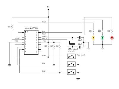

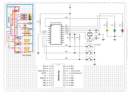

Step 3: Making Audio MUX Circuit
As circuit complexity is not high, the wiring of components is relatively simple as shown in the diagram above.
When pressing any tact switch, a pre-defined LED is turned on as follows.
-     The first tact switch (connected to RB0 port of 16F84) turn on the red LED (RA2)
-     The second tact switch (RB1) turn on the green LED (RA1)
-     The third switch (RB2) turn on yellow LED (RA0)
When any LED is selected, other LEDs are turned off instantly.
After a certain LED is selected, turn on the specific LED is continued until you select another by pressing the other tact switch.
