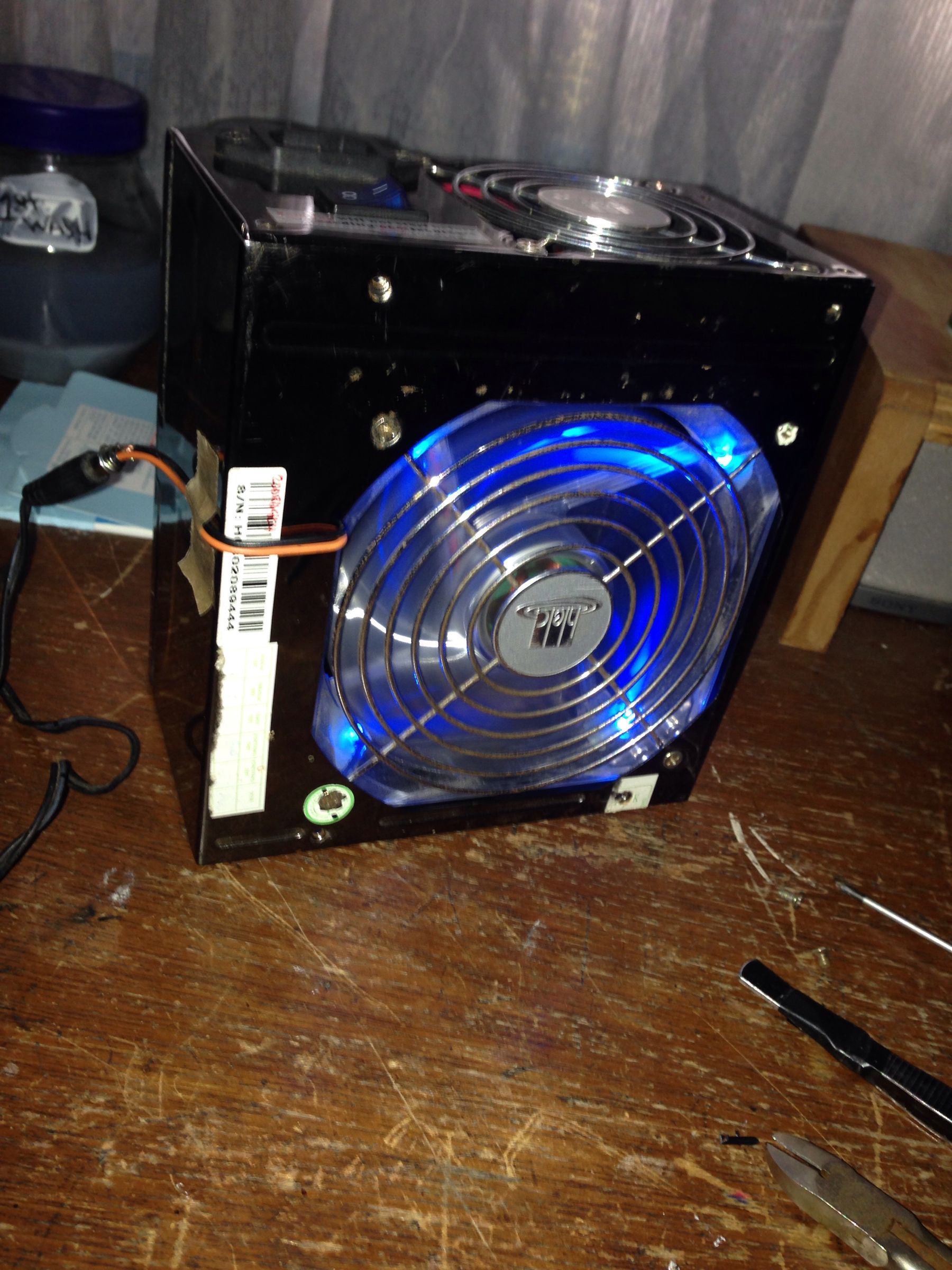

the 0v or GND in your power supply.. yes guys, we need to hook it up to our chassis.. and I recommend building your power supply externally because if you don't shield your transformer, chances are your project will still hum.
