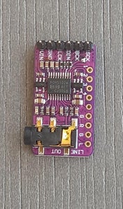

  • PCM5102A DAC module. The module must be able to be configured for "left justified" format.

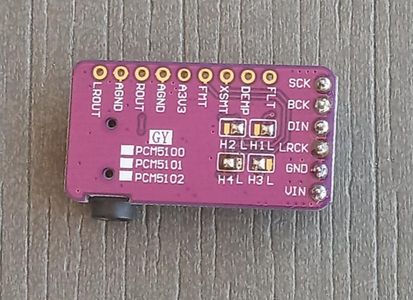

Step 1: Prepare the DAC Module
Use a soldering iron to remove the connection 4-L and make the connection 4-H.
This way the DAC is configured for "left justified" format instead of "I2S".

Connections between MCU and DAC
DAC------- MCU
VIN ------- 3.3V
GND ------ GND
LRCK ----- B12
DIN -------- B15
BCK ------- B10
