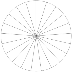

I used a template with a circle divided into 21 equal pieces for the placement of the RGB LEDs. Use a template to mark and drill out holes for the LEDs.
