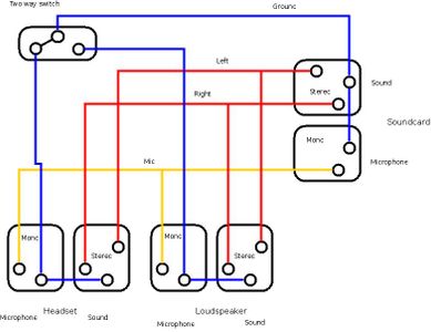

Step 3: Wiring
Solder the wires. The right two socket are the input, the downside four are the headset and loudspeaker output.
