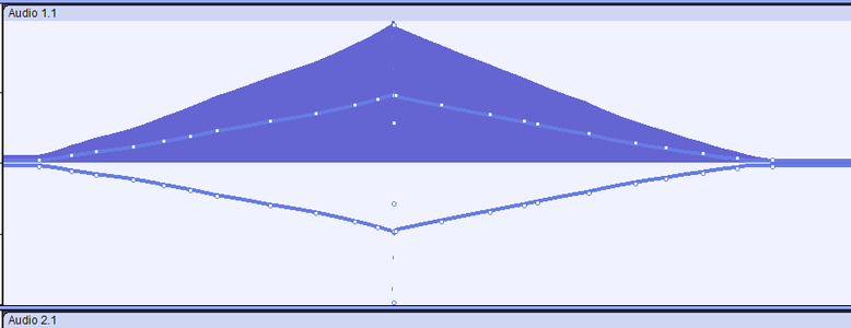

Step 3: The First Track
Now you've created a sound track that's just a long, blue stripe.If you play the track, you'll hear only a steady tone, the concert pitch a1 (provided you've left the frequency at 440Hz before).
You can already edit this track. Take the envelope tool. With this you can now click on the blue stripe and deform it. In the picture, you can roughly see what's happening. If you play the track now, you'll hear that the sound is louder in the higher places and quieter in the lower places, and you can't hear it at all in the narrowest places.
Step 4: The Roof Is on Fire
As you can see, the dots are always formed symmetrically around the zero line.That means you can't form the triangle for the roof, or just lie on the side.
Theoretically, you just need to lengthen the back a bit and you've created a house that's not standing, it's standing. But a house has to be right.

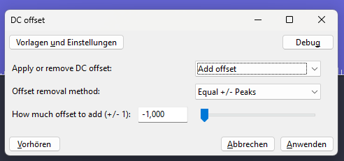

Step 6: The Roof Is on Fire. Again.
The first thing you do is edit the upper track, which is going to be the roof. The amplitude is still shifting symmetrically around the zero point, which you don't want. So mark that track and click on Effect. There, you'll find DC offset...
Take settings from the image.
This divides the upper track into an upper light blue and lower dark blue stripe.
The dark blue is the sound that will be played later.
