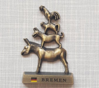

In my particular case, I visited Bremen, which is a city located in northern Germany. It is, among other things, known for its famous tale of the Bremen musicians.
I wanted to recreate the key scene of the story- the reason why the animals are on top of each other.
I don't want to spoil you the story, but I will tell you a couple of things about the Statue...It is said that if you touch the mouth of the donkey you will have good luck, and if you touch both legs you will return to Bremen one day. You will notice that many people touch both parts, the contact with the metal changes the color of the statue.

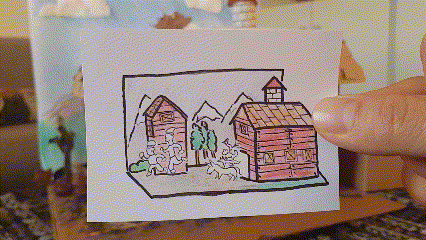

Start drawing: you can use a pen and paper. Draw what you think is important about the idea and let others comment on it as well.
Consider this step as: low-fidelity prototyping, because it essentially uses only pen and paper. In theory, low-fidelity sketches are faster to create. You can be as detailed as you want.
In my case I wanted to recreate a farm type scene, I wanted to highlight nature, musicians, and people who wanted to steal the farmers' valuables.

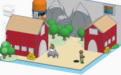

Going from 2D to 3D with Tinkercad
In this phase we are going to transform our drawing from 2D (paper) to 3D (objects with volume). Keep in mind that we want to highlight the most important ideas of our project. In my case it is a farm type scene with animals on top of each other.
I like Tinkercad because it is easy to use, has a good library with different models and is supported by Autodesk. We can model almost anything in a matter of minutes. It will also allow us to move to Augmented Reality. You can create an account here.
I invite you to browse my scene. Notice that I have represented as best I can the key things in my story. Feel free to zoom in and out and check it out from different perspectives as it's fun and interesting :)

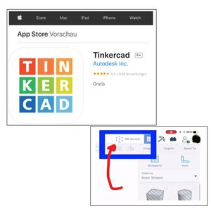

Step 5: Set-up Before Going AR

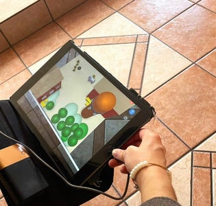

It is important to set up the iPad before going to the AR.
The first step is to download on the iPad the Tinkercad App, you can find it here. Then, on the iPad, log in to Tinkercad and browse the App until you find your 3D Model or Scene.
Once you have located the file you will need to open it, look for the AR icon on the top right of the Tinkercad workspace.
In case you don't have access to an iPad, I am working on a way to accomplish this without it. Once I figure it out, I will post it in the near future. In the meantime you can skip to step 7 or see step 6.
Once you are satisfy with the results, lets move on.
Step 6: Start AR
This is an interesting variation :)
Locate a clear and safe space around you and start the AR Experience. Keep in mind the position and scale while launching the model or scene. Once you achieve those steps, start exploring :)
