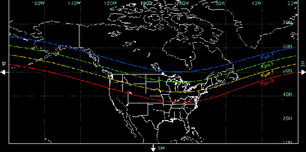

The kp index is a measure of geomagnetic activity. This is the index used on the map in the previous step. To be seen very far south, a high kp index is needed. An index of 9 occurs roughly four times per 11 year solar cycle. Lower kp indices are reached much more often. See this website (look under the geomagnetic storm tab) for more detail on the frequency of storm strength.

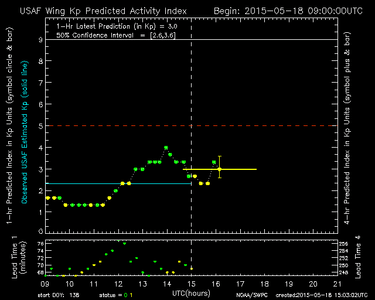

Predictions for the kp index are available for the next three days, as well as the next four hours and next hour. We will look at the sources for our program. (The image is a graph for the one hour prediction. This graph normally contains the four hour prediction, but that hasn't been working for the last month or so.)

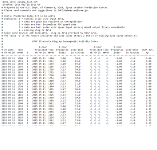

The first thing the program needs to do is determine if the aurora is going to be any good or not. One source I use is the wing kp model from NOAA. It is available here. If you select the data tab at the bottom, NOAA will give you the data for the graph as text, which is much easier to work with. This is what I use for my program. MATLAB has a built in function called webread that will read the data for me if I just give it the URL. Load this data into your program in whatever way works for you.
The numbers we are interested in are at the very bottom of the file; this is the most recent data. You can have a lot of fun scrolling up and down the file to look at the headers and the data you actually want. The only numbers in this whole file that we care about are the one and four hour predicted indices. If the model isn't working correctly, the value will be -1. Ignore anything that is -1. Once you have the most recent kp predictions (updated roughly every 15 minutes), the program can compare this to a threshold for notification that you set for your location. Most of the time, the prediction will be too low to notify.

When MATLAB uses webread, the data comes in as an almost 80,000 character string. This is not so good to work with. You can do what I did at first, which is just count which characters you want and set up MATLAB to extract the 77,312th through 77,314th characters, and hope NOAA doesn't change their formatting. I apologize to any computer programmers out there who are weeping at this method.
I want to force the chart into a matrix, with one number per cell. I did this by removing the headers. The headers end with a long row of dashes, so I removed everything before that. I then wrote the data, without headers, to a text file. When I load the data from the text file, MATLAB says, "Hey! This data is in nice, neat columns. How about I just put this in a matrix for you real quick. There you go. Nice and easy to use." Then the most recent kp prediction can be extracted without any trouble.

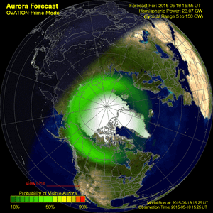

Another model I use to determine the chance of a visible aurora is the Ovation model from NOAA. The URL directly to the map as shown in the image isn't working for me now, but here it is if you want to try. The map is visible on the overview page for the space weather prediction center, available here. Scroll down until you find a map that looks like the one in the image. This model takes into account more factors than just kp indices, and gives a percent chance of viewing the aurora.
The raw data is available here. The headers are frustratingly vague, not giving a point of reference for where the data begins. Also, NOAA says there are 1096 longitude values, but I am fairly sure that there are only 1024 values. After a couple of hours of messing with it, I was able to use the raw data to make a map similar to the one NOAA makes, and compare to theirs to find a point of reference. I believe that the first row of data is for the south pole and the last row is for the north pole. The left column is opposite the prime meridian, and moves east around the globe. I compared calculates I made this way with a website that does a similar thing, and the answers matched up.
For the program, load the data just like for the wing kp model. The number to extract will vary based on each person's location, unlike the kp model.
To find which row of data to use, add 90 to your latitude (for the northern hemisphere) and divide by 180 (the degrees of latitude between the poles). This will tell you, as a decimal, how far down the chart to go. Multiply this decimal by the 512, the number of rows. Round this to the nearest integer, and use data from this row.
To find the column, use a similar method. Add 180 to your longitude (make sure it is negative for the western hemisphere), divide by 360, and multiply by 1024.
Once you know your row and column, it is fairly easy to extract the single data point that gives the percent chance of a visible aurora at your location in the next half hour.
