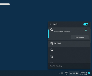

  1.  Use a computer to connect to the Wifi access point "WLED-AP" using the default password "wled1234".
  2. Configure your Wifi network and set up a mDNS address. The mDNS helps us assign a static ".local" hostname to Aurora. This helps us connect to Aurora at the same address every time it connects to our Wifi.
  3. Connect back to your network and access Aurora using the configured mDNS address.
