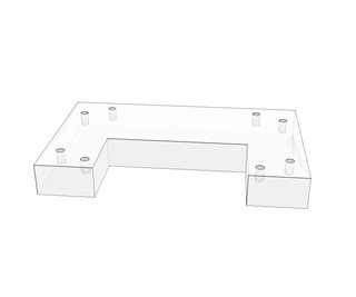

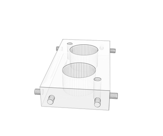

In the beginning god created Auto CAD.
I first drafted the parts that I needed in Auto CAD.
I have attached the full assembly and all of my custom parts that i designed.
I have also included the .stl for 3D printing
