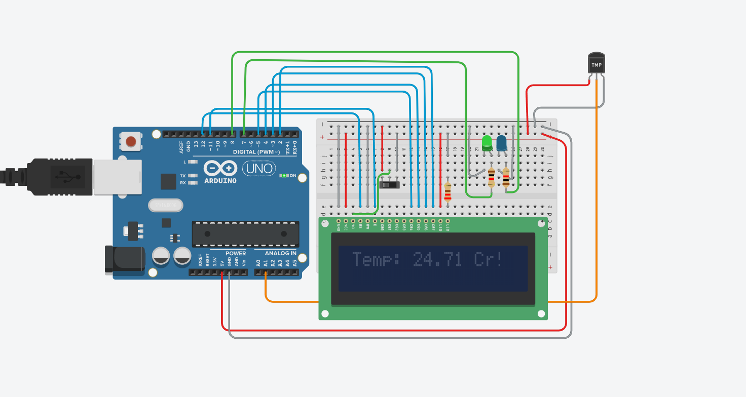

Step 4: Wiring L298N & RTC
This step will tell you how to wire the L298N & RTC
We will be starting with the pins 8, 9, 10, 11 to the L298N
- Pin 8 (White) to IN1
- Pin 9 (Purple) to IN2
- Pin 10 (Pink) to IN3
- PIN 11 (Yellow) to IN4
Next we will be connecting the Nema 17 to the L298N
- OUT1 to 1 on NEMA
- OUT2 to 2 on NEMA
- OUT3 to 3 on NEMA
- OUT4 to 4 on NEMA
Connecting 12v and Arduino to L298N (Couldn't find 12V so imagine 9V battery as power)
- Volts to 12V
- Ground to GND
- 5V to 5V on Breadboard
Connecting RTC to Arduino
- GND to GND
- SDA to A5
- SCL to A4
Jumper Pins
- All jumper pins are supposed to be on the L298N
