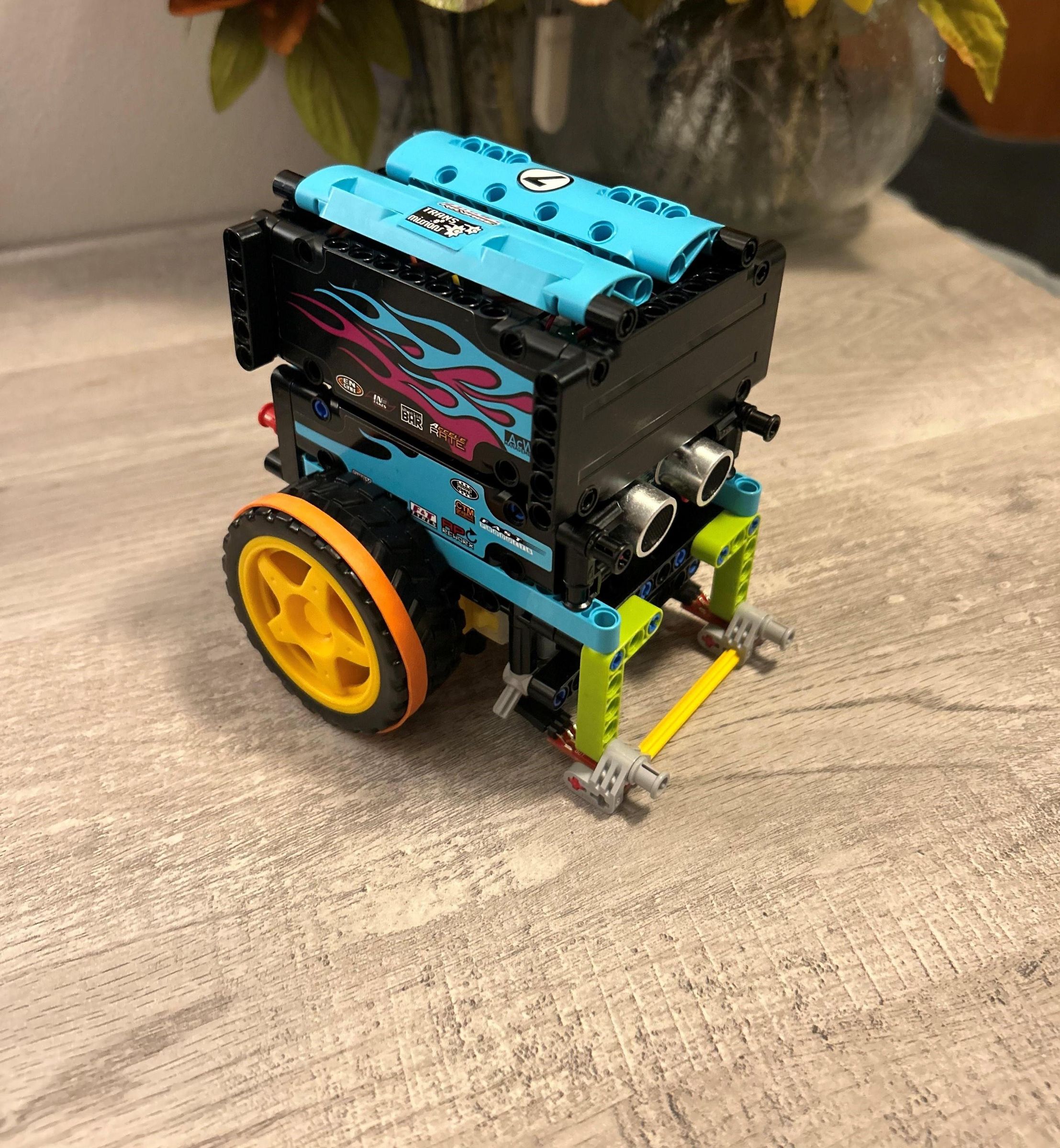

Step 2: Build
  • Secure down the stand for the motor and situate where Arduino bored will live with extra 9v battery
  • attach the drum to the DC motor I used a wheel that came with my Arduino kit centered it and attached the two together
  • create a roller to prop up the barrel and reduce the friction
  • make a grate that will sift the litter
  • also underneath the drum should live an excrement box where everything falls into once the drum rotates
  • cut a hole in the drum that aligns with the hidden excrement compartment
  • wire everything
  • create housing to cover everything
