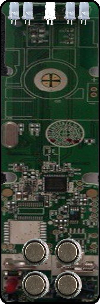

Step 2: Prepare Remote's Circuit Board
Connect 2 high gauge wires to the power "button" or any other button besides the mute button (What you attach it to determines what the remote will do automatically). Because the mute button is used to search for the required TV code, it is better off left untouched. One wire for each side. I found that the Thinkgeek conductive wire glue works best. (Solder doesn't seem to stick to the black conductive material) When to glue is dry, apply some superglue over the conductive glue to add strength.

Step 4: Assembling the Remote and Circuit
Take the back plastic case and drill a hole in it somewhere in the middle. It should be large enough for your 2 wires to pass through. Now slide the two wires through the hole and place the remote circuit back on the plastic case. Screw down the board using the 6 screws. Take the 2 wires and solder them to the relay. The wire should be soldered to the normally open position. (It should be wired so that most of the time it is off and is on when the timer sends the signal. Don't attach the other way around or else the remote will send the signal to the TV constantly.) Most likely the relay you use will be different than the one I used but you should get the same result.
