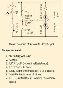

Hello everyone this is my first instructables of automatic twilight switch using ldr this is simple project for beginners like me the main purpose of this project is it will automatically switched on when its dark and automatically off in day
i used a very simple and popular timer ic 555

Step 2: Check Your Circuit on a Bread Board
connect all of your components according to the schematics
make sure the leds you are connecting 3-4 leds make sure connect them in a parralel
Step 3: Check It Is Working or Not
There may be two problems found on your circuit first is that set the potentiometer sensitivity if its low or too high may be the leds glowing all the time or not not glowing and the second is your connection are not connected according to schematics
Step 4: If It Start Working Solder It on Your Pcb
while you are soldering all the materials you can add any capacitor with leds that will help to make them glow instantly even in low light conditions and the resistance is depending on your led in my case i used a small notifying led thats why i connected two resistors in series
