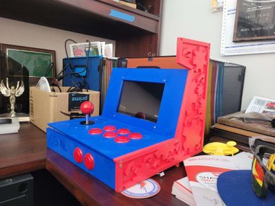

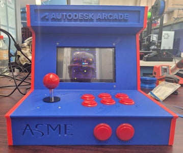

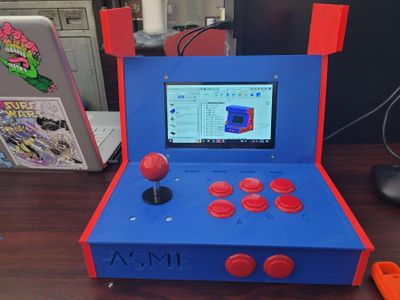

For this project, I wanted to recreate the arcade games I enjoyed at the Santa Cruz Beach Boardwalk as a kid as a portable desktop arcade! You can often find arcade games being sold at stores such as Best Buy for a whopping $500+. Additionally, finding a space in your household to store large arcade machines can often be very challenging and often isn't applicable.
Utilizing Sanwa arcade parts, an encoder, and a 7 inch display I was able to create a affordable arcade cabinet below $100! Furthermore, the arcade cabinet is within a 10 inch cubed volume, so it easy to store, place on your desktop, or display!

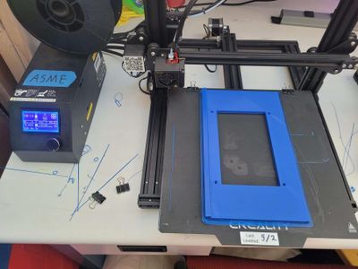

In order to 3D print the cabinet for my project, I utilized our club's Creality CR-10 printer and two spools of Matterhackers' Pro Series PLA and HTPLA. I chose red and blue as they are a common contrasting color choice for the cabinet to give it a clean look.
Additionally, in order to ensure the stability of the cabinet, I used some of the club's M3 screw inserts provided by ZYLtech engineering. These could be inserted with a soldering kit and ensured the rigid connection between portions of the cabinet.

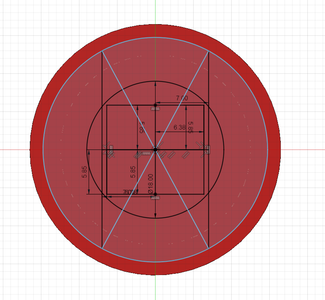

The Sanwa Buttons were a press fit into a cylindrical hole, so modeling the insert wasn't much difficulty. To account for the tolerances on the printer, I made the holes the buttons insert into at 29.70 mm. However, I manually created a Sanwa Button using my caliper in order to represent the model in it's truest form. This was because the electronic connections underneath the button are important for the wiring to the encoder, so I wanted to ensure I created enough space.
I was able to design the entire model within Fusion 360 and have it look nearly identical to the original model without any use of the original part's specifications.

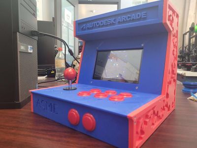

Step 8: Arcade Cabinet [Side Panels]
Using the redefining of the sketch plane, I was able to take each plate side profile I made and create a universal sketch of all the sketches combined. This allowed me to easily make the side panel and extrude it out. However, I found that once I had the model complete it felt incomplete without modeling a decal on the side panel. Often when you look at arcade cabinets they have a decal on the side panel to fill the space. Additionally this gravitates gamers to the cabinet as the side panel entices them to it. So for my side panel rather than printing out a sticker I wanted to embed a side panel decal using Fusion 360!
I utilized the circular patter tools to create some gears, then inserted some Autodesk symbols throughout the panel to make it look like the gears were pushing the symbols throughout the space. I then combined that sketch with the side panel sketch to make a border around the decal. It turned out really cool on the first attempt so I decided to keep it. However, in order to not have an inverted section on the opposite side of my sketch, I made a different decal on each side, though they look similar.

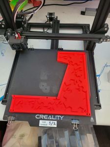

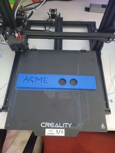

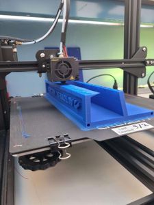

Now that all of the parts were modelled, I utilized Fusion 360's easy printing exportation tool to transfer the files into Cura's slicer program. From there, I printed all the parts on our Creality CR-10 printer!
In order to allow for the shortest print time possible, as you can tell by my modelling I set up the parts into plates so they could be printed flat then assembled. Each plate took between 12 to 36 hours to print. The printer was able to complete all the prints successfully and the parts came out really well. I attempted to stress test the printer by printing the top plate without support and that didn't turn out well, so I had to reprint the part.

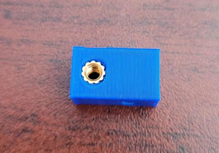

Step 11: Assembly [Soldering Inserts]

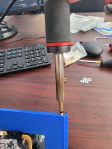

Once all the blue parts were printed, I needed to add our inserts into them. In order to do so I utilized our club's soldering iron and placed the M3 insert tip on the end. I heated the soldering iron until it was hot enough to push the insert in then pushed in the insert. I repeated this process for each blue plate.

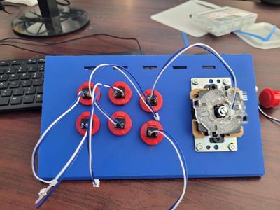

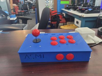

I then took the base plate and the front plate and began pushing in the buttons. I also took the joystick and screwed it into place using the #8 screws and a nut on the opposite side. In order to get the LCD into place I screwed it in using M3 screws and a nut on the opposite side.
Step 13: Assembly [Plates]
Once all the parts were mounted in their respective condition I assembled the module by mounting the blue plates to one red plate using the M3 screws, then repeating the process on the opposite side of the red plate I first mounted.

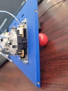

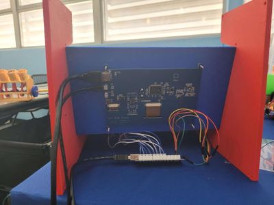

Step 14: Wiring

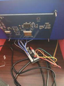

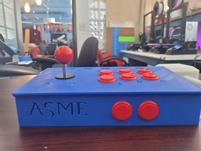

Now that the cabinet was built, I needed to wire the components to the encoder. All the button wiring went to the lower rack of the encoder, and the joystick needed to have 5 pins connected to the encoder. The encoder doesn't provide a wiring layout because it was expected to come with a 5 pin connection wire but I ordered it twice and it didn't so I just wired it myself.
Once the encoder is wired it can be powered via USB, as well as the LCD screen. The LCD screen also has an HDMI cord to attach to a PC. It's pretty wild to think you can have this arcade running with just two USB ports and an HDMI. I could probably figure out a future wiring solution that makes it just one USB and an HDMI too!

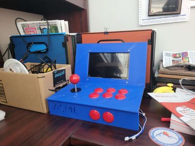

Step 15: Time to Game!
Now that the cabinet is built and wired properly, you can start finding the games you'd like to play and run them on any PC. You can additionally run other games besides arcade games as the cabinet acts as a controller as well!
