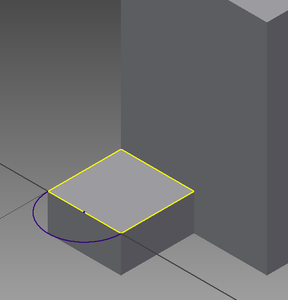

Step 5: Create a Sketch on the Work Plain.

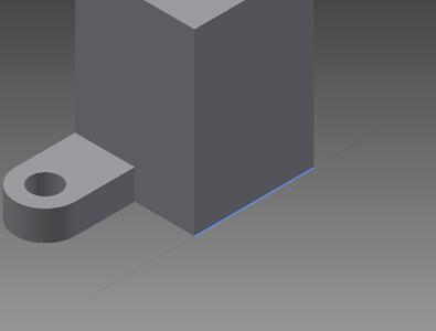

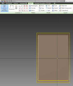

  1.   Create a sketch on the work plane.
    2.     Click the projected Geometry button. This will project the edges of the object on to the work plane.
    3.     Click the left and bottom edges of the object. They will become a bold yellow. (Refer to Image)
    4.     Create a rectangle in the bottom left side of the work plane. The length should be 1’’ and the width should be .5’’
    5.     Finish the sketch.
    6.     Extrude the sketch through the block 4”. This will create 1” wings on both sides of the block.

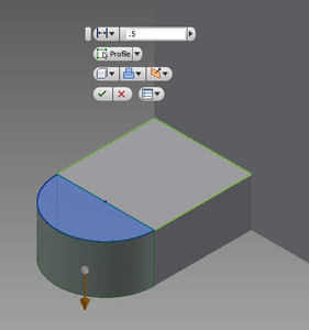

Create an arc to finish the wings.
  1. To get rid of the work plane, right click on it and then click the Visibility button.
  2. Create a sketch on the top face of the wing.
  3. Press the Arc button and select Center Point.
  4. Select the center of the wing and drag the arc to one edge and then drag it around to create an arc on the edge of the wing.
  5. Finish the sketch and extrude the thickness of the wing .5’’.

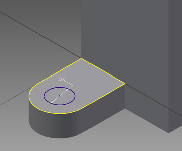

Step 7:
  1. Create a sketch on the top of the wing.
  2. Draw a circle using the center point of the arc. Dimension it with a diameter of .5’’.
  3. Finish sketch.

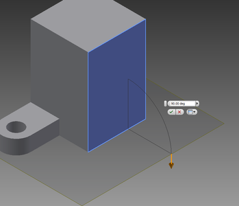

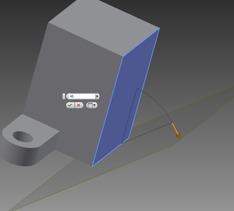

Creating a work plane to cut the angle in the block.
  1. Select the Plane button again.
  2. Select the option of “Angle to Plane Around Edge”.
  3. Click the edge of the bottom and right faces of the object, then click the right face.
  4. In the Plane Edit Box type 45°.

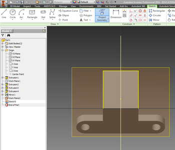

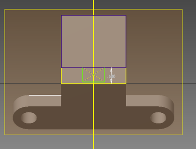

Step 10:
1.       Using Projected Geometry, project the edges and the top of the object and the plane the block was drawn on. This can be done by going through the Origin planes on the left of the screen until the plane the block was drawn on shows up. Click on that plane to project it to the work plane.
2.       Create a rectangle on the top and side edges of the center block.
3.       From the bottom of the block to the bottom of the sketch should be .5’’

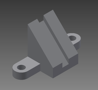

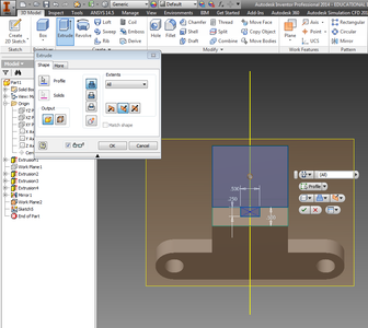

Step 11: Creating the Channel
  1. On the same work plane make another rectangle centered on the block underneath the first rectangle. To do this, click the Rectangle Options and select "Rectangle Two Point Center”.
  2. Select the center plane and then drag the rectangle to the bottom of the first rectangle.
  3. Dimension the height as .25’’ and the width as .5’’.
  4. Finish the sketch.
Step 12:
Extrude both rectangles at the same time. Select the "Through All" and "Cut" options in the Extrude Edit Box.
