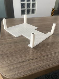

- Glue the M3 size nuts into the hexagonal holes of the chassis spacers. If the holes were too large, we applied tape to the outside face of the nuts to increase their width slightly and make a tighter fit. If too loose, we used a soldering iron to melt the nuts into the hexagonal holes.
- Glue the four spacers to each corner of the bottom base with the flat side down. The side with the hexagonal and circular cuts should be facing upwards. Wait until the glue has completely dried and there are solid joints between the spacers and the bottom base.

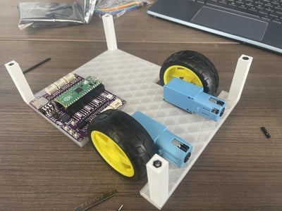

- Place the MakerPi Pico, DC motors, and motor driver as shown above and begin connecting them using jumper wires and following the given schematic. If necessary, solder wires onto the DC motors.
