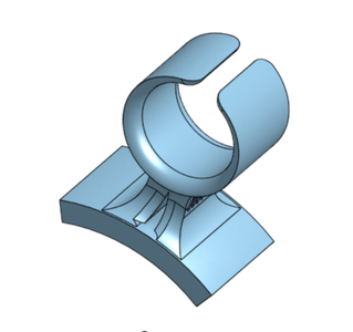

Step 1: The Cad Conseption
For a precise and efficient build, I used Onshape, an online CAD platform, to design the parts of the telescope. In projects like this, precise simulations are crucial to ensure all components fit together perfectly before starting physical assembly. Onshape allowed me to create detailed models of the telescope tube, Dobsonian mount, and motor housings, simulating how they would interact. This step saved time and materials by identifying potential alignment issues early in the process. Additionally, the collaborative features of Onshape made it easier to iterate on the design and ensure each part met the project’s objectives for smooth movement and accurate tracking.

Step 5: Telescope Body
For the body of the telescope, I repurposed some tubes I had available at home. To ensure a smooth and precise movement, I 3D printed two parts that allow the smaller tube to slide inside the larger one with a secure and fixed translation. This design helps maintain stability while adjusting the focal length. Additionally, I created a holder part that features a simple screw nut system, which, combined with bearings, firmly secures the body to the previous assembly along the Y-axis.
For the lens installation, I designed and 3D printed specific fittings for each of the two parts, allowing them to attach directly to the tubes without the need for glue. This modular approach not only simplifies assembly but also makes it easier to replace or upgrade components in the future. Overall, these design choices contribute to the telescope's functionality and adaptability, ensuring a reliable structure for observing celestial objects.
