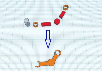

Hand:
For Hands Group two, Boxes, two Tubes, one Hole Cylinder and A Solid Cylinder. Arrange them as in picture 3 above and group them all.
