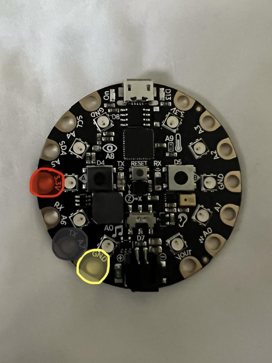

Part One: Where to Connect
Our goal is to the wires of the motion sensor to the pins of the Arduino. The lArduino has many pins to connect external sources to and the motion sensor has three seperate wires. For this to work properly we need to connect the wires as follows.
Red connects to 3.3V pin
Yellow connects to ground pin
Black connects to A7 pin
Part Two: How to Connect
Now that we know where to connect the wires lets get into the how. We will first start by stripping back an inch of the plastic covering over the wires. You can do this by lights cutting through the plastic layer with a pair of scissors, rotating the scissors around the wire, and sliding off the covering.
Once the plastic covering is off and your wire is exposed simply wrap the wire through the hole and around the metal portion of the pin 3-4 times.
Repeat this for each wire and their respective pin location.
