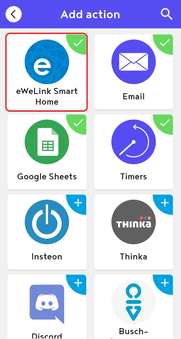

Step 2: Connect Olisto and Ewelink
Follow the steps in the tutorial below to connect Olisto App and eWelink
https://ewelink.cc/ewelink-works-with-olisto/

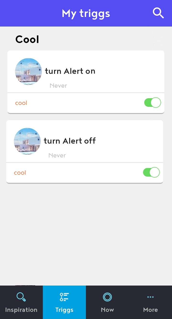

Step 5: Create New Trigg to Turn Off the Smart Switch Device
Create new Trigg. Please follow all steps indicated above. This trigg will turn off the smart switch once at home.
