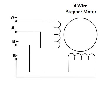

You will need to determine the wire pairs for each coil of the stepper motor you are using. If you have the data sheet for the motor then this information will be provided. In the absence of a data sheet a multimeter can be used. Take one wire and check its resistance against each of the three remaining wires. Whichever wire shows the lowest resistance against the first wire is its pair mate. The remaining two wires are also a pair.
Once you have determined the coil wire pairs, you will need to attach them to the EasyDriver board. The first coil pair should be soldered onto the Coil A+ / Coil A- interface pins (on the reverse of the protoyping board). The second coil should be soldered to the Coil B+ /Coil B- interface pins (again on the reverse of the protoyping board). You can try soldering a pin header to the interface pins if the stepper motor has a connector on the end of its cable, otherwise solder the stepper wires directly to the interface pins. There is no polarity on the coils, so you cannot plug a coil in backwards. If, during use, the motor turns opposite to the currently selected Clockwise / Counter Clockwise parameter, simply swap the pairs (or change the direction in the software).
Note: Do not connect or disconnect the motor while the Easy Driver is powered. If any of the motor wires comes loose while power is applied, the driver can be damaged.
If the motor skips steps then you may have to tweak the adjustable current controller on the board. The EasyDriver supports motor currents from 150mA to 750mA by turning the onboard potentiometer.
More current equals more torque, more heat, less speed and more motor noise
Less current equals less torque, less heat, more speed and less noise
The recommended way to adjust is to turn the current all the way down to minimum. Then turn the potentiometer slowly to the point where the motor no longer skips steps. Selecting run with it set to video mode, the highest speed and the largest angle is the best way to judge this. The faster the motor is set to move, the higher the risk of skipping steps, so doing the adjustments at the highest speed is recommended.
