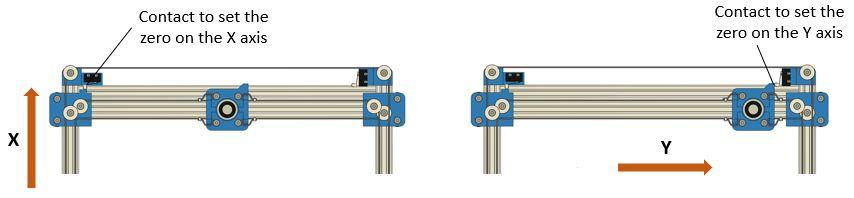

- 2 x Micro Limit switch roller

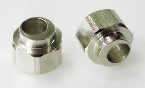

- 4 x Eccentric Spacer - M5

For a proper functioning of the sliding, the contact force or gap between the wheels and the beams is essential. If the gap is too tight, the sliding will be difficult and if it is too slack, the guiding will be not accurate.
It is impossible to obtain the good contact force only from construction, so a set up system shall be implemented. Eccentric spacers are used to set the good gap adjustment between the wheels and the beams. Turning the eccentric spacers increases or decreases the gap and will give the best compromise between the guiding and the sliding.

At the start-up, the X & Y coordinates of the trolley will be unknown, so at each commencement, the system needs to set the 0 for the X and Y axes. The setting consists in moving the trolley following the X and Y axes up to limit switches. The limit switches are fixed to the frame so that at each new start the 0 will be at the same location.

- Slide the trolley to the trolley beam. Adjusted the friction gaps with the eccentric spacers in the aim to obtain an easy sliding. Assemble and add the two pulley supports at each extremity of the trolley beam
