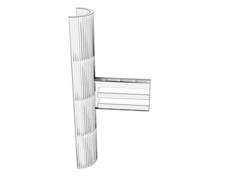

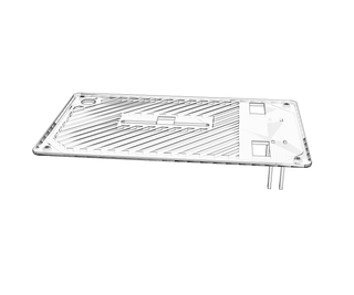

7. 3D Print an Enclosure Lid
8. 3D Print a Cigar Holder

I have included the .STL and .IPT files of the two 3D printed components. .IPT is and Autodesk Inventor part file.

The Cigar Servo will require a way of mounting it stationary centered underneath the square cut out of the lid. I used the optional shelf for the electronics box and used zip ties to secure the servo to holes that I drilled. There are many ways to achieve this stationary hold. The servo will need the long arm and will need a small screw threaded into the last small hole. This screw will slide up and down the groove on the cigar tray to enable the servo to transport the cigar.
Step 3: Moving on to the Lid
The lid will need the remaining two servos to pop up into place. You will also need to mount the safety switch as well as the capacitive touch sensor. Having these items secured to the lid we will need to test all the electronics before closing the box up.
