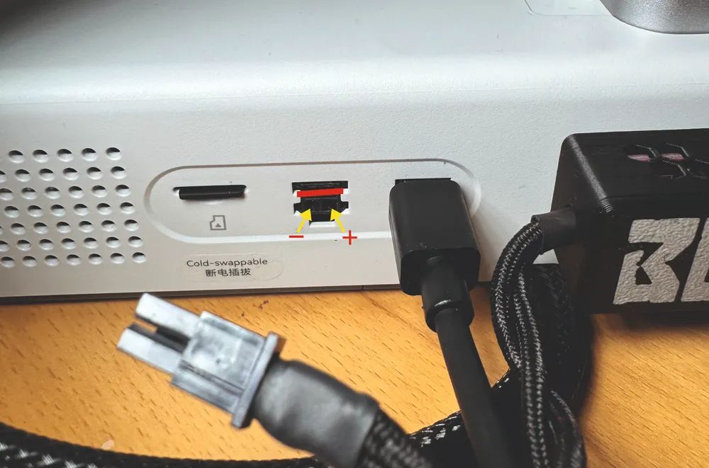

Start by using the molex connector to pull 24v out of the second AMS plug. I learned about this from this project, who apparently learned about it from this project. There is a picture below to diagram which of the four molex terminals are + and -, the other two will be unused.
Wire the 24v to the buck converter, and take it down to 5v for the pi and the relay module to use. The 24v will also go to power the small fans, via the relay. That relay will be switched by the pi on pin 28.
