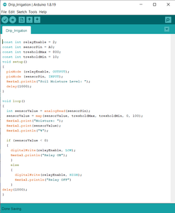

Step 2: Code
Code source: Salih Zeki's Smart Irrigation project
I uploaded the code to my Arduino Uno. Start by download the Arduino IDE Software then copy and paste the code below (all previous default text on Arduino IDE can be removed). Compile the code and uploaded it with a USB-A to USB-B cable.
Code:

Once done uploading the code, plug in the 12v power supply and test the electronics. Ensure that the lights on the 5V power supply and Arduino Uno turn on and that the motorized ball valve opens. Test the moisture sensor by dipping it in wet soil and checking that the motorized ball valve closes.
