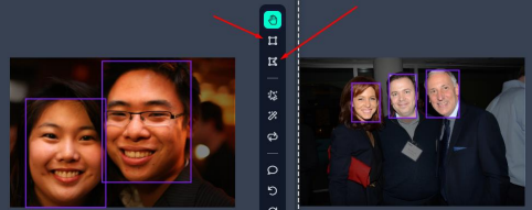

2. Data Annotation: Use Roboflow to annotate images by drawing bounding boxes around faces.
More detailed information can be found here: https://blog.roboflow.com/getting-started-with-roboflow/

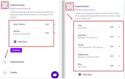

  • Preprocessing and Augmentation: Resize images to 640x640. Apply augmentation techniques like flip, rotation, shear, and brightness to enhance the dataset.

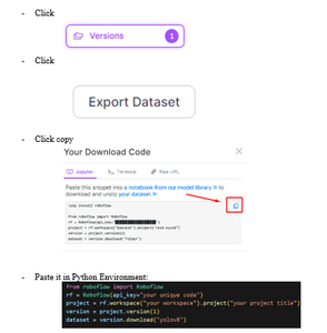

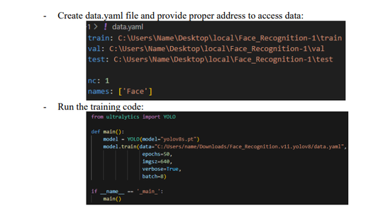

  • Model Training: Train the model using YOLO v8 in a Python environment. First you export the dataset from Roboflow:

  • Software Deployment: Deploy the trained model, make the connection to the Raspberry and enjoy the results.
