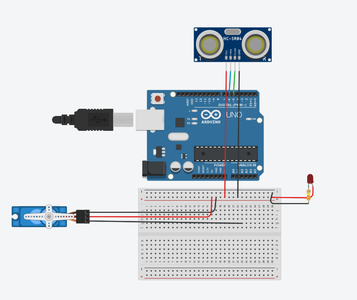

Step 6: Assemble the Circuit
  1. Position the servo motor at the top of the garage, ensuring it can freely operate the door. Cut a slit or hole in the cardboard frame to accommodate the motor's movement.
  2. Connect the servo motor to pin 3 on the Arduino.
  3. Connect the distance sensor's echo pin to pin 5 and the trig pin to pin 6 on the Arduino.
  4. Connect the LED through a 330-ohm resistor to the breadboard’s power rail and its cathode to the ground rail.
