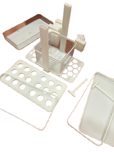

Step 1: Prepare & Print Structural Parts
  1. Print the reservoir and grow-tray STL files (scale the model by a factor of 2 and use ≥ 20 % infill).
  2. Clean supports and seal internal surfaces if needed.
  3. Dry-fit all 3D-printed parts before inserting sensors or tubing.

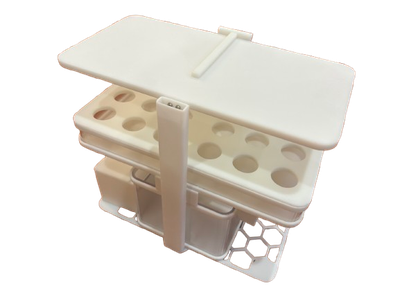

Step 2: Assemble the Farm
Reservoir (bottom) – mount water pump, EC & pH sensors, temperature probe, and MSP20 level sensor.
Grow tray (mid) – insert XU5-1 level sensor and air stone; route overflow drain back to reservoir.
Lighting rack (top) – attach the LED panel and the cooling fan.
Connect tubing for nutrient flow and fresh-water inlet (valve-controlled).
Check seals and prevent water near electronics

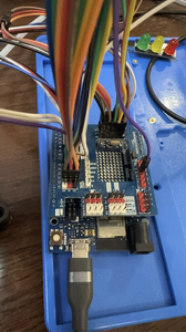

Step 3: Wiring & Arduino Setup
Mount the Arduino UNO R4 WiFi inside a waterproof box.
Wire sensors and actuators to separate analog/digital pins as in the Pin Assignment table (page 78).
Keep 5 V and 12 V lines isolated; use common GND.
Add LED indicators (Green = Stable, Yellow = Adjusting, Red = Critical).

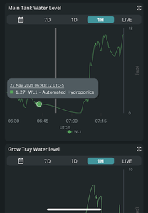

Step 5: Connect to Arduino IoT Cloud
Create a new Thing and import variables for pH, EC, temp, water levels, and status LEDs.
Link dashboard widgets (gauges, charts, switches).
Test real-time updates and alerts via email or phone notifications.

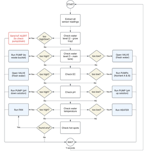

Step 6: Automation Logic
Target ranges
  1. pH ≈ 5.8 EC ≈ 1.6 mS/cm
  2. Water depth (grow tray) = 3 – 5 cm
  3. Temp ≈ 18 °C
Logic flow
  1. If pH ↑ → dose “pH down.”
  2. If EC ↓ → run Nutrient A/B pumps.
  3. If the reservoir is low → open the fresh-water valve.
  4. If tray dry → alert + stop lights.
Target ranges
  3. Temp ≈ 18 °C
Logic flow
  5. If thermal hotspots > −0.5 Laplacian → start fan.

Confirm live updates on IoT dashboard and alert emails
