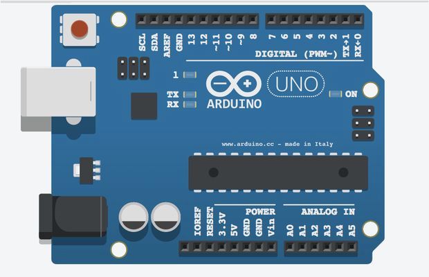

- Microcontroller - WiFi enabled - Wemos D1 Mini in this case as it is so small and powerful.
- Linear rod assembly, stepper motor with endstops
- Remote control interface - In this case a Raspberry PI hosting a small simply WebApp to control the opening and closing of the lamp.
Step 1: WeMos D1 Mini and ULA2003 Programing
WeMos D1 Mini microcontrollers can be purchased for around £5 online from eBay or similar. They are great due to their small size and reliable WiFi connectivity along with many GPIO pins 6 of which are needed for this project. 4 for the stepper controller and 2 for the endstops.
The Arduino IDE was used to program the WeMos as follows:

Step 2: Linear Rod, Stepper Motor and EndStops
Images showing push button EndStop test rig then final mounted microswitch EndStops
Step 3: Final Wiring and Pre Launch Testing
Rather scruffy looking but most of the cabling is hidden from view once the outer shell panels are installed on the lamp.
This photo was mid way through soldering the components together and cabling them together pre go live.
