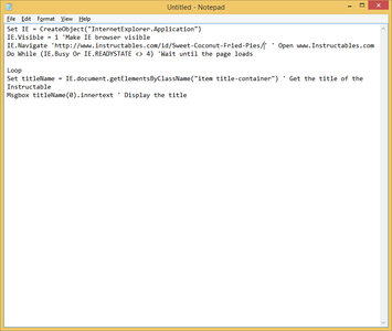

To test the above code, open a note pad and write the below lines and save the note pad as .vbs file and double click the .vbs file
'Copy and paste the below code in note pad and save as .vbs file
Set IE = CreateObject("InternetExplorer.Application")
IE.Visible = 1 'Make IE browser visible IE.Navigate 'https://www.instructables.com/id/Sweet-Coconut- Fried-Pies/' ' Open www.Instructables.com
Do While (IE.Busy Or IE.READYSTATE <> 4) 'Wait until the page loads
Loop
Set titleName = IE.document.getElementsByClassName("item title-container") ' Get the title of the Instructable
Msgbox titleName(0).innertext ' Display the title

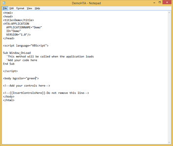

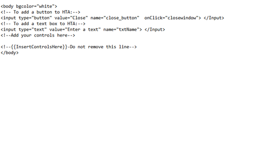

Open a blank note pad in the system and past the below basic HTML structure and save the file as .hta (ex: DemoHTA.hta)
Step 1: The basic HTML structure (Refer Screenshot 1)
Step 2: Adding objects to the HTA application Add the necessary objects inside the body tag in the HTML (Refer Screenshot 2)

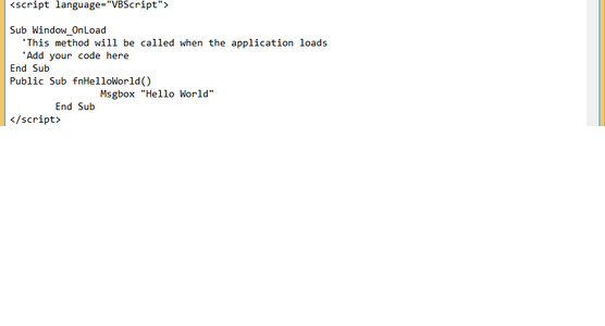

Step 3: Adding the script to the HTA application Add the functions that are required inside the script tag (Refer Screenshot 3)

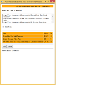

2. Added a simple internet automation script to capture the views and favorite count from the browser
3. Display the score in the HTML application

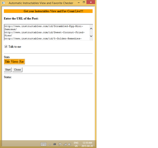

1. Right click the file below and save it as a .hta file in desktop and run the application.

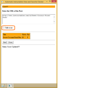

2. In the opened application, Provide the web page address of the instructables (If more than one Instructables then provide the address in the new line as shown in the pic) that you wish the tool to read the count in the box (Refer Pic 2)

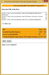

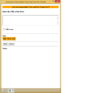

2. Check the 'Talk to me' check box if the tool has to read the score out loud (Refer Pic 3)
3. Click on the 'Start' button (Refer Pic 3)
4. In couple of seconds, application will get the views and favorite counts of the instructable and displays it in the application
