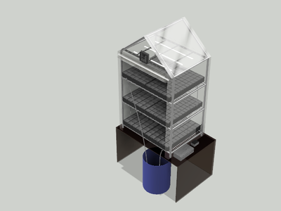

Seedlings are often needed to start a garden, especially if you live in areas where summer season lasts just a few months. Usually no one has a luxury of many window sills and even if they do, it is all too dependent on sunny days. Automated propagator with climate control not only helps to sprout seeds faster, do it in a controlled manner, but saves space too. Herbs, vegetables, flowers - all of the seeds can be started in such propagator! Disclaimer: this project mostly concentrates on how to automate propagator not how to build one from scratch, but if you need more details on any aspect of this project, let me know!

4. Wemos D1 R1
5. 4 way 5V relay
6. Humidity&temperature sensor DHT11
7. FC-28 soil moisture sensor
8. DC12V 3W micro water pump with DC connector
9. DC12 V fan
10. DC12V heat mat
11. 12V DC power supply (~5A, depends on how powerful pump, fan and heat mat is)
9. 12V DC 5m of 6400K 25W/m (1700Lm) and 5m of blue 3, 6 W/m LED strips
10. 150W 12V power supply.
11. Wires, silicone tubing
Step 1: Wiring
Connect wires as shown in the picture:
1) DHT11 signal pin to D2;
2) FC-28 sensor signal pin to A0;
3) Connect relay pins In1-In4 to D3-D6 respectively;
4) Connect LED positive lane through relay 1, pump - relay 2, fan - relay 3, heat mat - relay 4.
GND pins to GND, Vcc to 5V.
