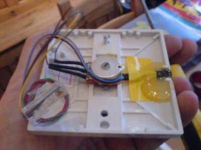

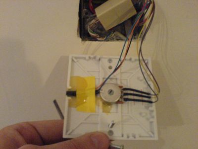

Below are some pictures showing the insides of these units:
First the single dimmer.
You'll notice also that there is a small black device at the bottom of the unit:
This is a temperature sensor that I use to control the heating, it uses the same enclosure as the dimmer units and the same run of cabling, but they are two separate systems.
The double units are a bit more busy inside, but essentially just two singles in the same box.

These dimmer control units are connected using Cat5e cabling back to my understairs cupboard, where the rest of the kit is.
The control units (as you can see from the pictures above) can be easily disconnected from the wall by unplugging their RJ45 plug from the connector. Each dimmer location in the house has a single run of Cat5e to it all home ran back to under the stairs.
The units themselves simply act as a potentiometer, the variable resistors have 3 legs, looking from the front, the leftmost one is grounded, the middle one (the wiper) is the output, and the right one gets 10 Volts DC.
Notice the use of heatshrink sleeving and a dab of epoxy to hold everything in place, this makes for a more reliable unit I've found Connecting them up in this way means that as you turn them clockwise from off to on, the voltage on the middle leg rises gradually from 0v to 10v - This is used to control the dimmer units manually.

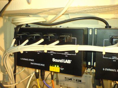

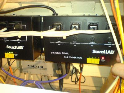

Step 3: Dimmer Racks
The dimmer units take the 0-10v signal on a 5pin DIN connector (1 pin is ground the other 4 represent the 4 channels) and they take the DMX signal on a 3pin XLR connector. DMX devices can be daisy chained as each one has its own id set, if you look closely at the picture above you can see an orange cable (0-10v signal), a purple cable (DMX daisy chain link) and a yellow cable (DMX in from the DMX controller)
Here are some more pictures of the dimmer racks:
Across the front of the rack you can see a bundle of 1mm T&E cable, each one of these goes to a different lighting location throughout the house. Quite simply this cable runs from the dimmer straight to the light fitting in the ceiling, this does make the wiring of any light fittings very easy, as there is just a single cable to contend with. These cables are connected to the dimmer racks using male IEC connectors (the male version of a kettle lead)

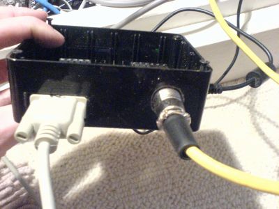

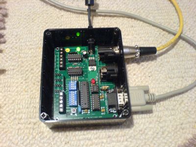

Step 4: Serial to DMX Conversion
The DMX signals to control the dimmers come from the unit pictured above. This device takes a RS232 (serial) signal from my home automation server and converts it into the DMX protocol. This allows me to control the lighting throughout the house automatically, and means that you don't actually have to use the dimmer control units in each room, this is really the whole point of automating the lighting, I have sensors in each room (standard security PIR sensors) that are being monitored by my home automation system, if movement is detected then the server sends a serial signal to the DMX controller to bring up the lights in that room etc...
Additionally it means that you can operate your lights over the internet, via SMS, IVR etc.. which can be useful.

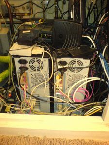

Finally a picure of the rear of the server that connects to the DMX interface, this server is used to control the DMX interface.
....More about that in the software section below.

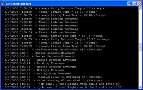

All of my other home automation (security, heating, power, cctv etc..) is written (badly in parts) using perl.
This lighting project is no different, although it does represent my first attempts at using web services.
For the web services I've used Apache 2.x and the Soap::Lite module for perl, to actually talk serial to the DMX controller, I have used the perl module Device::SerialPort.
The whole lot runs under Redhat Linux I call the web services from my actual home automation application like this: (note this is a part of a much larger program)
# Lights off if no movement for ten minutes and movement more recently in the hallway
if ( $epoch - $in11_lastmove > 600 && $in11_lastmove < $in23_lastmove && $kitchenlights == 1 ) {
&send_lights_soap(1,0) ;
$kitchenlights = 0 ;
The actual subroutine being called is here:
sub send_lights_soap {
$soap_response = SOAP::Lite
-> uri('http://192.168.101.172/Lights')
-> proxy('http://192.168.101.172/cgi-bin/lights')
-> send( "$_[0]" , "$_[1]" ) ;
$res = $soap_response->result ;

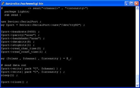

And as this is a web service, the actual serial interface and web service code resides on another machine on my network, the web service code looks like this:
#!/usr/bin/perl -w
use SOAP::Transport::HTTP;
SOAP::Transport::HTTP::CGI
-> dispatch_to('Lights')
-> handle;
# Call as -> uri('http://192.168.101.172/Lights')
# -> proxy('http://192.168.101.172/cgi-bin/lights')
# -> send("" , "")
package Lights;
sub send {
use Device::SerialPort ;
my $port = Device::SerialPort->new("/dev/ttyS0") ;
$port->baudrate(9600) ; $port->parity("none") ;
$port->handshake("none") ; $port->databits(8) ;
$port->stopbits(1) ; $port->read_char_time(0) ;
$port->read_const_time(1) ;
my ($class , $channel , $intensity ) = @_;
# send data out
$port->write( pack "C", $channel ) ;
$port->write( pack "C", $intensity ) ;
sleep(1) ;
$port->close() ;
return "Done! I used $class with chn $channel and inten $intensity";
Fairly simple code, I'm sure you'll agree, and best of all, because it runs webservices, I can spread these nodes out across my network and call them easily.
