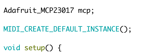

Step 5: Coding the Arduino and Understanding MIDI
To program the Arduino you will need to install the latest Arduino IDE and learn how to do some basic things like upload to your Arduino and install Libraries. There are many guides on the internet on how to do this and it the process dosen't fit into the scope of this build.
Once you are comfortable using the Arduino IDE you will need the following Libraries.
After you have installed those libraries download the code from this instructable and copy and paste into the Arduino IDE.
Without attaching the MIDI board that you created, upload the code to the Arduino. Once the code has been uploaded hook everything up, press the reset button on the Arduino, and test that everything is working as it should.
NOTE*
Different xylophones have different note arrangements so the exact code that I wrote might not work correctly for your xylophone. But this is an easy fix. Refer to this MIDI note chart and change the note number in the Arduino code to correspond with the notes of your xylophone.
