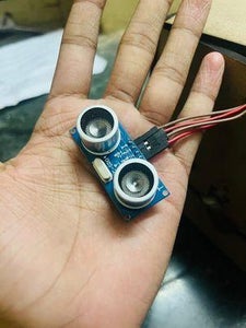

It works on the principle of ultrasonic waves sent and received by the ultrasonic sensor.

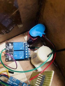

2.Relay Module
3.Ultrasonic Sensor

9.mini-jet submersible water pump

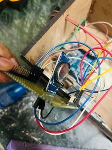

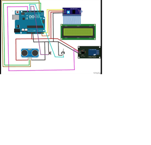

Step 1: Connection
Connect All The Components As Shown In Schematic Diagram
