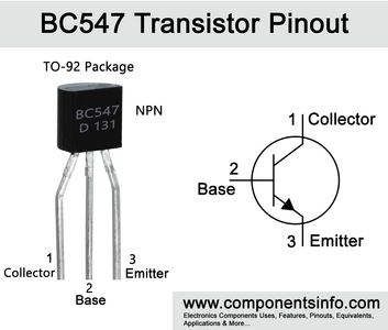

1) ANY NPN TRANSISTOR( I HAVE USED BC547)

Step 2: CURCUIT DIAGRAM
HERE
*THIRD LEG OF NPN TRANSISTOR WILL CONNECT TO GROUND AND THIRD LEG TO ONE TERMINAL OF WATER SENSOR.
*MIDDLE LEG OF TRANSISTOR TO SECOND TERMINAL OF WATER SENSOR.
*FIRST LEG OF NPN TRANSISTOR TO -VE TERMINAL OF LED AND ALSO TO WATER PUMP....
THE POSITIVE TERMINAL OF WATER PUMP AND LED TO +VE TERMINAL OF SENSOR AND BATTERY!
I HAVE ALSO UPLOAD A CIRCUIT DIAGRAM.
BUT IN THIS CIRCUIT DIAGRAM
##** I HAVE ADDED DC WATER PUMP WITH LED **##
WHICH IS NOT SHOWN IN CIRCUIT DIAGRAM
