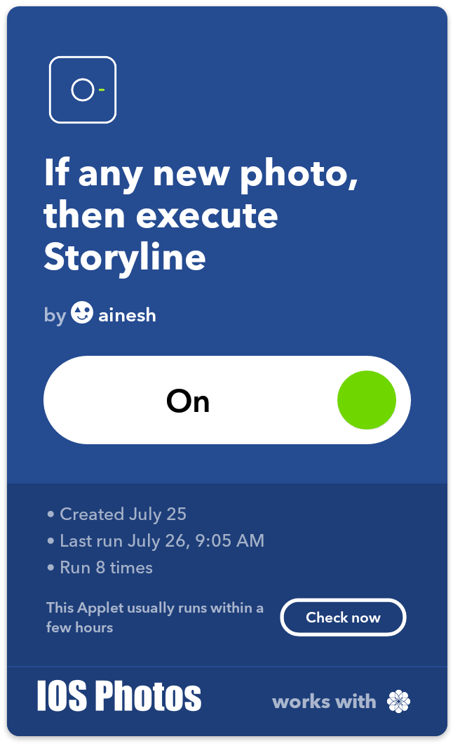

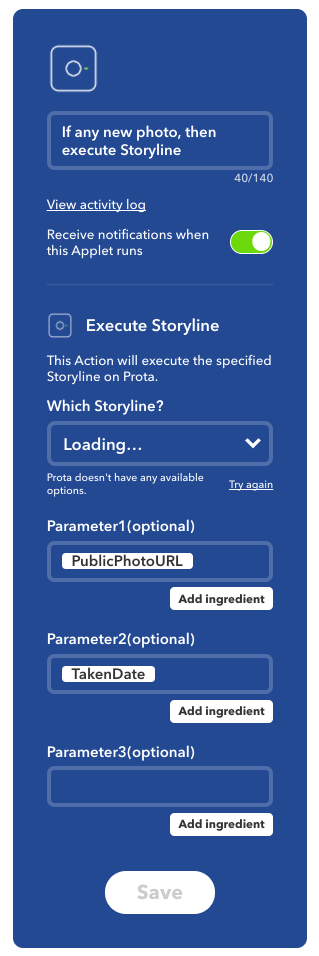

IFTTT applet
Now, we need to create the IFTTT applet that will send the images you take from your phone to your Prota.
Go to IFTTT.com and create an account. You can also download the IFTTT app on your smartphone and sign in.
- Search for ‘Prota’ and connect your Prota Space account to IFTTT (you need to use a device which has access granted)
- Start creating a new applet
- For the IF part, select IOS photos and select “Add any new photo” (or another option that would fit better your expectations) and add it.
- For the THEN part, select Prota and use the option “Execute Storyline”. Select the storyline you wrote earlier (starting with When IFTTT run a Prota applet”) and set the Parameter1 as “PublicPhotoURL” and “Parameter 2” as “TakenDate”.

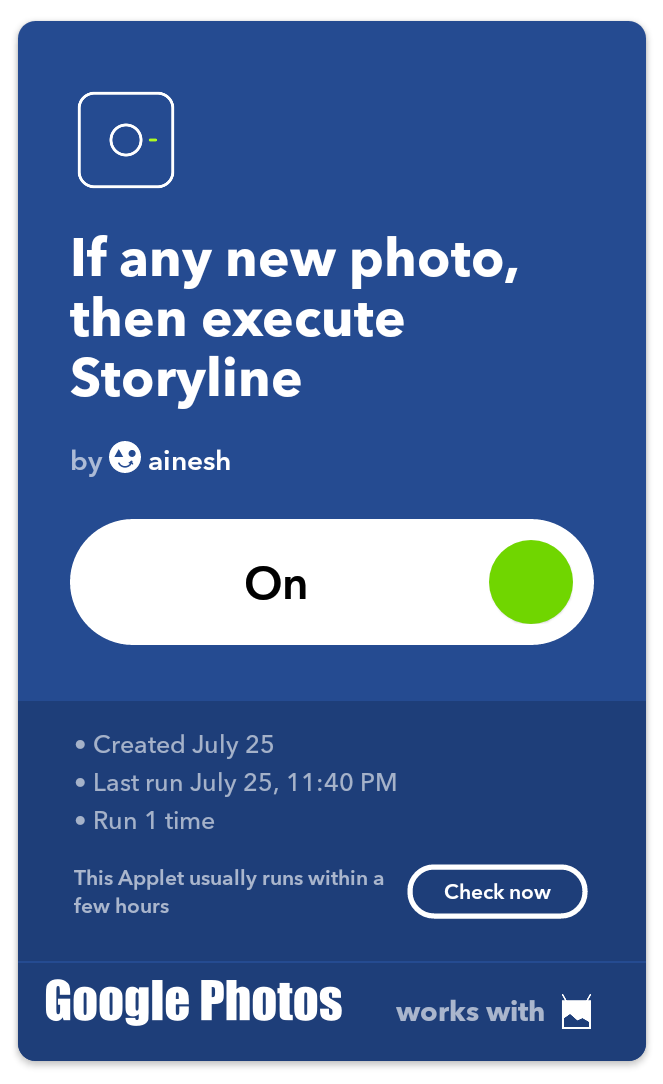

Alternatively, you can do the same procedure and create an applet for the Google photos as well.
Below is a detailed image on how to set the settings for the applet.
