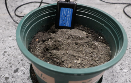

1. The soil testing kit is equipped with soil sensors, which simultaneously measure the soil moisture and soil conductivity of multiple flower pots. Based on the preset values in the program, it determines whether the corresponding flower pots are lacking water or nutrients, and then sends irrigation and fertilisation instructions via Bluetooth.

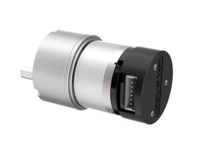

- 3x soil sensor (see image 1)

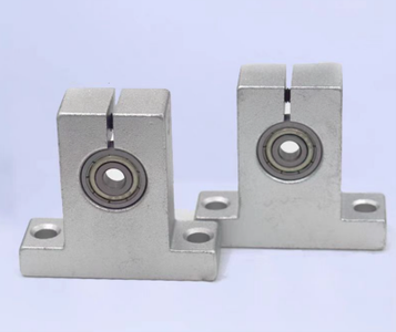

- 2x DC motor and motor mounting base (see image 3)

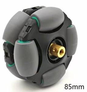

- 4x omniwheels and corresponding coupling, shaft, bushing, shaft sleeve (see image 4,5)

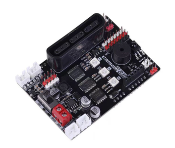

- motor driver expansion board (see image 6)

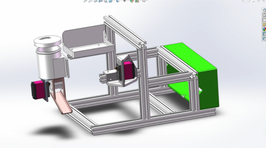

Step 1: Design & Modeling

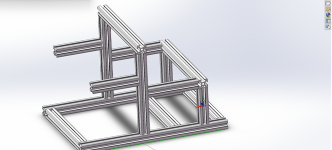

To facilitate future expansion and modification, aluminium profiles are used for the vehicle body construction. Other structures can be made using 3D printing. Considering that the water tank capacity should not be too small (I used one around 3L), the vehicle body should also be made as large as possible, as space permits. Therefore, I completed the initial design of the model using SolidWorks and assembled it using assemblies to facilitate subsequent size measurements.
I have attached my complete Bambu Labs model below. Refer to this often as you work through the steps, since it is the easiest way to see how everything is attached.

Before assembling, it is recommended to connect the circuit and conduct a test first. For example, check whether the direction and speed control of the DC motor are normal, whether the suction force of the water pump is sufficient, whether the battery and expansion board can simultaneously power 2 DC motors, 3 servos and 1 water pump, and whether there will be insufficient power supply, etc.

Step 3: Assemble Vehicle Body Frame
The assembly of the aluminium profile frame is relatively simple. No additional processing is required during ordering. Common L-shaped angle brackets and T-shaped nuts are sufficient to complete the connection of the frame. It is also very convenient to make subsequent structural modifications.
After installing the four wheels, the chassis height is determined. Then, based on the diameter and height of the flower pot, the length and height of the mechanical arm when it rotates and unfolds are determined to ensure that the water pipe and fertiliser outlet are above the flower pot.
I have uploaded a copy of the frame I used.

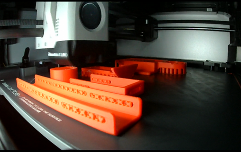

Step 4: 3D Printing
Based on the determined vehicle body dimensions, continue to design the servo motor mounting base, fertiliser box, and waterproof shell for electronic components, etc. These structures do not have high strength requirements and can be produced at a low cost using 3D printing. The subsequent modifications are also relatively simple. I have attached my designs, but you are welcome to adjust them according to your preferences.
Except for the mounting base, which needs to bear force, it is recommended to use a fill of 100%. For other parts, a 15% fill is sufficient.

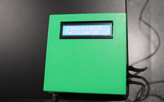

The monitoring end does not require movement, so no battery is needed. A DC power supply would be a better choice.
After setting up the display and sensor circuits, write the program for reading and displaying the data, observe the display effect of the values, then water or lift the sensor probe, and observe whether the change in humidity is normal.
After testing, use the 3D-printed casing to prevent the circuit from being short-circuited by water.

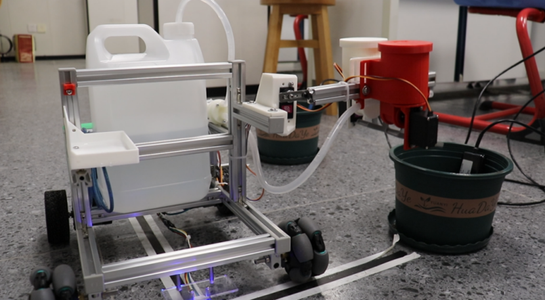

Finally, the automatic pathfinding and robotic arm programs are combined to enable the car to automatically locate water-depleted or fertiliser-deficient flower pots and automatically perform irrigation or fertilisation tasks.
Note: During the testing phase, it is recommended to set a status variable for the servo motors of the robotic arm. When the robotic arm is retracted, it cannot perform irrigation and fertilisation actions.
Conclusion:
The feasibility of this current plan has been verified. In the future, a lifting mechanism could be added to the robotic arm, combined with the use of a pot rack, to achieve vertical three-dimensional planting and increase the utilisation of space.
