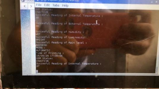

To measure the internal and external temperature within our project, we use two pieces of DHT11 temperature and humidity sensor. The external has not much function but it can be help in giving the current measurement of the external temperature. While the internal temperature gives signal to the fan and the servo window to open once the printed temperature value increases from 30 which is to be shown on the LCD TFT that we provided with the Raspberry Pi on it. Otherwise, if the temperature value is less than 30 the fan and the servo window will be close.

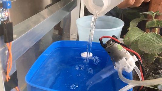

The soil moisture sensor helps in measuring the humidity of the soil. If the soil measurement value is determined as wet, the water pump won't sprinkle water on the plant to avoid drowning it. And if the soil measurement value is dry, it will pump the water and sprinkle on the plants. The luminosity is for the sunlight measurement. As the value of luminosity is printed as bright, the bulb won't open, and if the printed value is dark the bulb will open to give enough light to monitor the plants even at night.

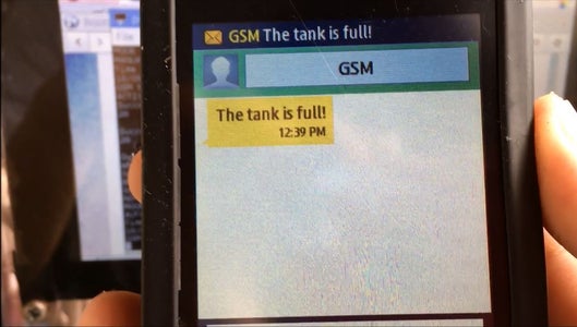

Here is the twist on our project, we had this rain steam sensor in which we use it as the signal for the servo roof to open and close. As the rain steam sensor sensed some rain drops the servo for our roof will automatically close to cover the plants because we designed our acrylic case with a hole on the center to mount our automated roof. And if there is no water or rain drops on our sensor the roof will open. Lastly we had this ball float switch, when the water level on our container is full the ball float switch will signal the GSM to send a message written "The Tank is FULL!" to the plant owner. This GSM availability is only for manual mode, and will be inactive once it is switched to automatic mode.

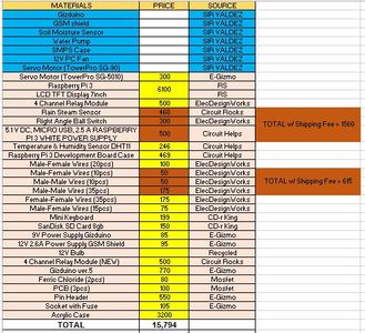

Step 2: List of Components
Remember to be more careful on handling the sensors especially upon testing or troubleshooting. We took time on troubleshooting each components and manage to replace it as soon as possible.

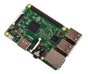

We installed the MySQL server and the Python bindings for MySQL. For the web server we installed the Apache2 package, putty and VNCTight Server.
Raspberry script:
For this script, we used the MySQLdb library. The script is the bridge between the Arduino and the raspberry pi. It allows us to save the data from the Arduino board into the database and send the new set point values defined by the user into the Arduino program.
