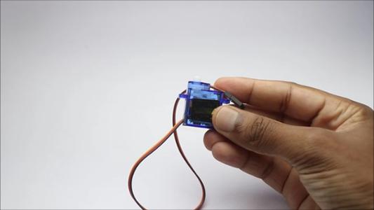

Servo Connections
Connect the red wire of the servo to the 5V pin on the Arduino and the black or brown wire of the servo to GND pins on the Arduino
Now Connect the yellow or orange wire of the servo to pin 9 on the Arduino. This pin will send the control signals to the servo to move it to the desired position.

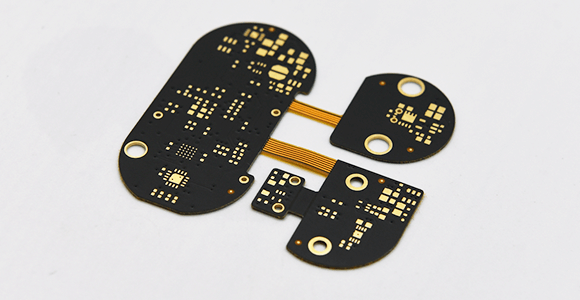

Check Here for Rigid-flex Pcbs with this your circuit becomes flexible! I have added the images to this step kindly check.
A revolutionary solution that combines the best of both rigid and flexible circuitry to elevate your electronic projects to new heights.
With their expertise in advanced manufacturing techniques, they offer a seamless integration of rigid and flexible components, ensuring enhanced reliability, durability, and space-saving benefits.

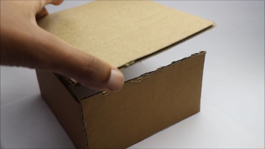

To build the model house i made use of the cardboard from my parcel boxes! This is a genius way to build such models where you can expect high quality of models.
Who doesn't know how to build a house! we all grew up making cardboard and paper houses and now if that skill is still within you you can make your own design.
If you are struck simply follow my steps and make this house, I used pieces of cardboard strips and to couple them i used hot glue.
Make sure you have some extra space by the side of the house and now the space here is for placing the electronics! You are wrong if you think that space is for making a pool or a small garden.
After the house is dry and strong enough we can head over to place the electronics.

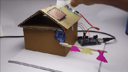

When it rains the first part in the house that will know is the roof itself, So i have installed the rain sensor on the roof, make sure you hide the amplifier module away from rain because rain will affect the working of this part.
After this we can head over to installing the servo, to make this first you have to power on the project and add a drop of water to the sensor.
Note the movement of servo and adjust in such a way that that cloth will be kept for dry by default and when the servo is activated upon rain detection the servo move towards the house along with the clothes.
I made the clothes with paper just to show that really works, Glue this part to the horn of the servo using hot glue and wait for drying.
Now again test the working of the servo and now the project is ready for some action.

The rain sensor is active and if it detects any rain/water drops it will activate the micro servo, the horns of servo rotate getting all the line of cloth to the shade hence preventing from getting wet.
Like i said the rain sensor is very active, Now if the rain stops the servo again move the line of cloth and now the cloth is kept for dry again.
