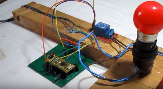

Step 2: Connection
There are two components you have to connect with Arduino:
1. Ultrasonic sonar
2. Relay Module
Now you have to fix the components in separate places. Ultrasonic sensor has to be fixed on the locker near to the key opening. Then wire it towards the control table where you are fixing your Arduino, Relay and Bulb. (You can refer my video link, for more clarity).

Let's see the connections.
*The Bulb has to be connected to the Relay module.
Now let's see how to connect the above components to Arduino:
1. Ultrasonic Sonar
It has 4 pins. Connect with Arduino as mentioned below:
i. VCC - 5V
ii. Trig pin - Arduino digital pin 5
iii. Echo pin - Arduino digital pin 4
iv. GND - Ground Pin
2. Relay Module (One channel Relay module).
Relay module has 3 pins on one side. Connect with Arduino as mentioned below:
i. VCC - 5V
ii. GND- Ground Pin
iii. IN - Arduino digital pin 3
In the other side of the Relay module you will find 3 pins named as below:
i. NC
ii. COM
iii. NO
This side, you are supposed to connect your bulb.
- Take the Life wire of the Bulb in your hand.
- Cut it in the middle using a nose player.
- Now you have two terminals of Life wire.
- Connect one terminal in the COM pin of relay.
- Connect the other terminal to the NO pin of the relay.
Now you are all set!!! :)
