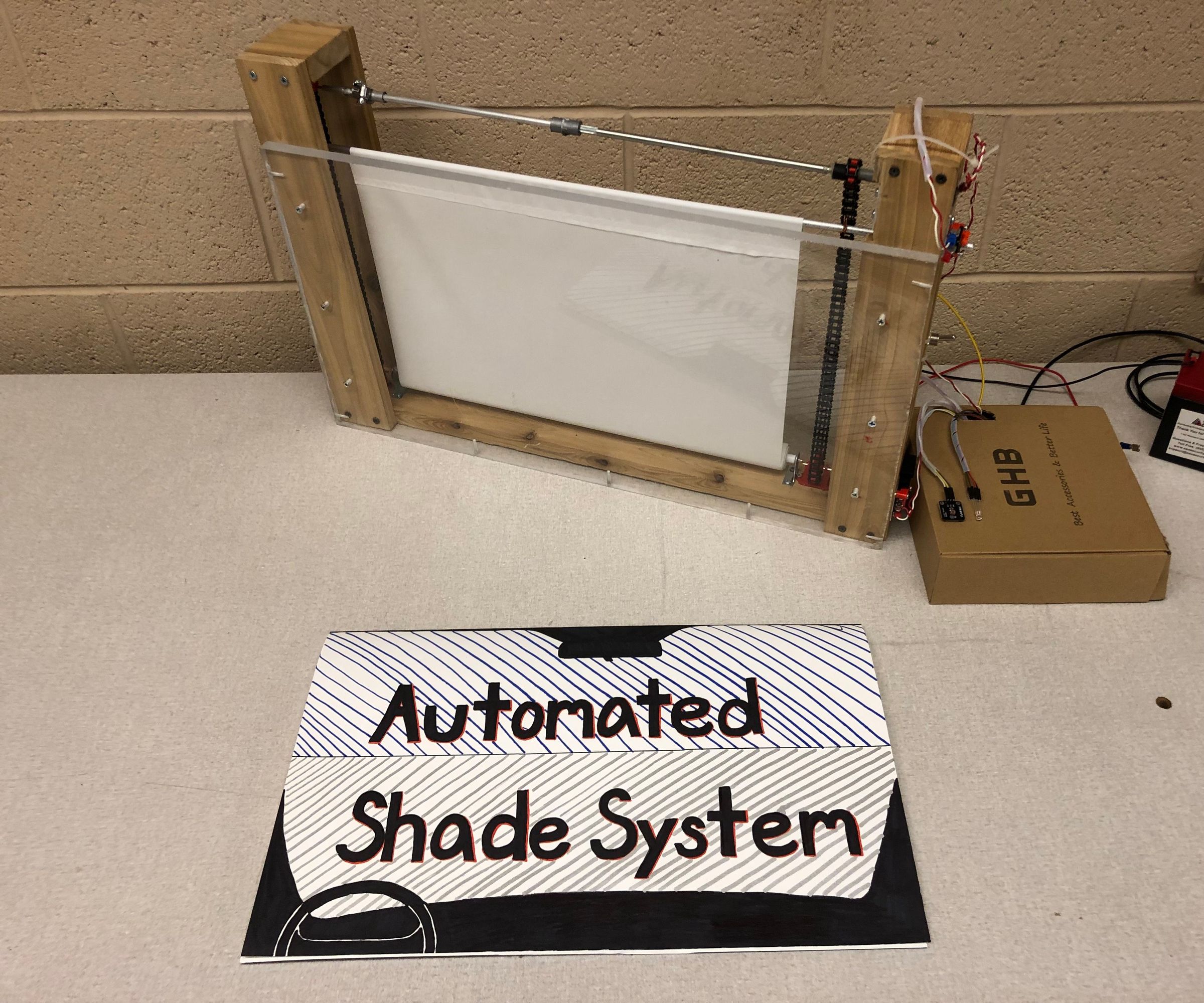

Step 5: Product Cunstruction
The product was to be constructed so that it could be made with parts fairly easy to obtain.
The physical frame was made of just cedar wood and screws.
Frame is 24 inches long by 18 inches tall. it is roughly a 1: 3 scale of a full size average vehicle windshield.
The physical product has two plastic gear and chain kits, two metal rods, and a roller shade.
A gear is connected to the DC motor, it rotates a metal rod which acts as a driver shaft that controls the chain movement. The driver rod was added to have the shade move evenly.
The gear and chain allows a different metal rod to lift and lower the shade, and acts as a trigger for the two limit switches.
The roller shade originally had a locking mechanism in it when purchased and I took it out. This gave the roller shade the ability to be be pulled up and lowered down without locking into a position once lifting movement stopped.

Step 9: Final Product
I put all the wiring inside the box to protect them from being damaged or removed causing the circuit to possibly not work.
The video displays all possible settings for the automated sunshade. The shade goes up, then light is covered to bring the shade back down. This works only because the temperature threshold has been met, if the temperature was not warm enough the shade would not move at all and would stay down at the bottom in a resting position. The temperature required for system to work can be change and adjusted as desired. The toggle switch in the video is to demonstrate when the vehicle is turned on or when wanting to stop providing power to the motor.
The product is completely portable and autonomous. It is designed to be a item that is built into a vehicle as a automatic shading system, but can use current construction for outdoor shading systems or inside a house for windows.
