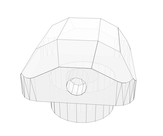

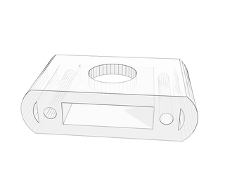

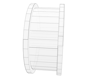

So for this project several different parts need to printed out in order to build the physical components of the tank. The number of each are as follows:
Axle X 2
Barrel X 1
Base X 1
Turret X 1
Wheel X 4
I've included the .stl files so that they can be printed out.

Step 2: The Prints
All the .stl files that were included are in inches, so if your 3D printing software requires metric or automatically converts to metric, then you will need to convert (I had issues getting my prints because of this). Once you get the prints, any supports or support strips will need to be removed (usually a fingernail is is good enough to get them off). However, I left the supports on the wheels to give them a look of treads.
Check to make sure all the mechanical parts have enough freedom to move - the turret should be able to rotate freely through the hole in the top of the base, the axles should be able to rotate in the holes on the side, and the axle should be able to fit through the hole in the wheel.
Any assembly of the mechanical components should wait until after the electronics are assembled and mounted.
