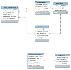

First execute the database dump file in "docs" in your database. you can use MySQL Workbench for this.
Then you can setup a venv. and install the librarys as documented in requirements.txt

To use theater timeline. First start making a production. In this production you can add scenes.
Start with the slave channel on 0, this will put it into waiting mode. Start increasing the channel value to go to the next scenes. Once all scene have passed, the display will show that the show is finished. Once finished slide the channel back to 0. This will save the recorded data. Once you have one recording you are ready to start using the device. It will automaticaly predict how long it is till the next scene starts. The more performances you have, the more accurate the result will be.
