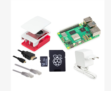

Raspberry Pi 5 - 8Gb Starter Pack (2023)
Powerful computing for real-time AI/traffic monitoring

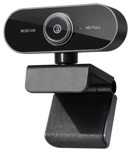

USB Webcam (+ Microphone)
Captures traffic footage for computer vision

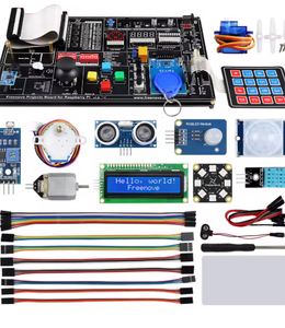

Freenove Project Kit for Raspberry Pi 5
Sensors, wires, and parts for prototyping

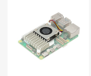

Active Cooler for Raspberry Pi 5
Keeps the Pi cool for stable, long-term operation

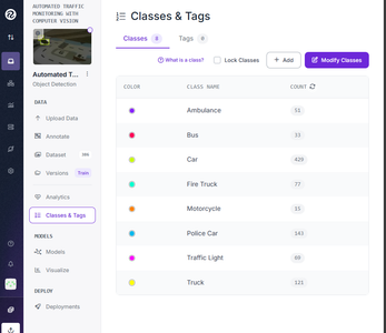

To ensure the model could reliably detect all relevant objects, I created a custom dataset using my webcam and a set of toy vehicles representing each class: Ambulance, Bus, Car, Fire Truck, Motorcycle, Police Car, Traffic Light, and Truck. I placed these on a three-way intersection map and captured hundreds of photos per class, making sure to include various angles and lighting conditions. Each image was annotated in Roboflow, with traffic lights included as a separate class so the model could distinguish them from vehicles. This careful annotation is crucial for robust, real-world detection.

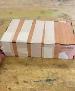

Step 2: Hardware Assembly and Housing
All electronics are housed in a custom laser-cut wooden box, painted black and gold with a silver lid and engraved branding. The Raspberry Pi, LCD, and wiring are neatly organized inside. The three traffic light modules are mounted on 3D-printed bases, which fit into holes on the intersection map. All cables are routed under the map for a clean look, and the webcam is mounted for a top-down view. Only jumper wires were used, soldered with extension cables to reach all traffic lights under the map, ensuring a tidy and robust assembly.

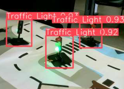

With the dataset ready, I trained a YOLOv8n (nano) model for 120 epochs ideal for real-time inference on the Raspberry Pi 5. The model was trained to recognize all eight classes, including traffic lights, using robust augmentations for lighting, angle, and position. The trained model was exported as ONNX for deployment on the Pi. The result: high accuracy for all vehicle classes and reliable detection of both moving vehicles and static traffic lights.

  2. Runs real-time detection using the YOLOv8 model.
  3. Assigns detected vehicles (excluding traffic lights) to Road 1 (right), Road 2 (center), or Road 3 (left) based on position.
